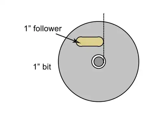

I think I have a good idea of how to do this with a plunge router and 1" bit.
I'll cut the first slot using a fence attachment. And then I'll mount a 1" hardwood follower to the base... (I'm ok with drilling a couple holes in it).
Because the follower is effectively only a half fence I'll probably need to do a plunge entry for subsequent slots, and then rotate/switch directions for the exit. I could probably use the completed half as a template, or just repeat the process. I guess I could rout both halves as a single unit and then cut it in half/assemble/trim.
