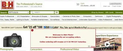

Check out how B&H Photo/Video handles this. They allow the site to remain active but inactivate the cart functions.
This handles the no work/commerce on the sabbath.
There will be an SEO issue if you deny access to the content.

    Wikipedia says: [B&H Photo] is owned by Herman Schreiber. Schreiber and many of the store's employees are observant Satmar Hasidic Jews who close the store on Shabbat, most Jewish holidays (except for Hanukkah, when business dealings are permitted), and Christmas. The website remains open, but orders are not taken or shipped between Friday evening and Saturday evening and on Jewish holidays. – Stephen Ostermiller Mar 09 '16 at 14:54
    +1 for a real life example. For a better customer experience, you might want to suggest something where customers can put orders into a queue, which isn't processed until the day ends. This way you're less likely to lose or frustrate customers who don't want to, forget to, or can't come back later. (whether the client wants to is of course their decision, but if they accept this compromise, it's much better for the customer) – user56reinstatemonica8 Mar 10 '16 at 00:44

It's not about whether the web site is up or not, it's whether they're using it. If they are observant than they will not be turning off/on electricity, cooking, or going near a computer / phone. They will not be interacting with the site and that is sufficient for them to be observant. If they want the rest of the world to be observant too, well that's a different matter entirely.
But... going back to the OP's question:
he wants his site to be offline somehow (or at least online but unavailable for surfing) during Saturday... ... Is there a way to achieve this goal without causing SEO problem of any kind to the site?
To address this strictly you need:
  1. every single page on the site to not be missing or give an error so as to not upset incoming links, visitors, or spiders
  2. presenting a page in each that does not degrade the searchable content of the site. That is, you haven't materially changed the presentation of purpose or use, just disabled it.
  3. timed to the appropriate local blackout period
  4. not mysterious to a user. That is, giving a reasonable explanation so as to drive a customer away.
In short, a Javascript solution that dims the page, pops up explaining that the site is observing a religious observance, and when they should return.

Reminder: A web-server isn't Jewish and doesn't parse human morality. I'm not sure why it must be shut off to traffic because of what an old book said.
Anyways the way I would handle this is display a friendly message to humans, something along the lines of "YOU'RE A SINNER!", then use a 503 header wrapped with source side schema.org (metas or JSON-LD) to continue to display backend information for bots trying to index.
Easy peasy, no hassles involved.

We often think of E-commerce sites as digital stores. If any finance portions can be deactivated on the Sabbath, it might be more appropriate to think of it in this case as a digital poster or booklet. Would you take all of your posters down for the Sabbath?
If that's not enough, I would try to convince them of the JavaScript solution. Tell them it's a "closed sign". It's very reasonable to think of it in that way.
