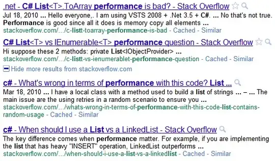

I'm not sure why we would need this field, as Google seems perfectly capable of showing the relevant search terms in context in the search result pages, like so (I searched for c# list performance):
google keyword highlighting
In other words, where would a meta description summary improve these results? We want the page to show context around the actual search hits, not a random summary we inserted!
