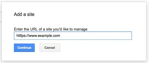

Google Webmaster Tools treats HTTP and HTTPS as separate sites and you cannot inform Google using Google Search Console, that you moved from HTTP to HTTPS since the address move tool does not support protocol changes
You can though add the HTTPS site versions. When adding a site, simply type the URL including the https:// prefix. You will then have two sites in Google Webmaster Tools.
Screenshot of "add a site" dialogue
This fits with the general principle that http://www.example.com is considered a different URL from https://www.example.com and may validly serve different content, Google is OK with that. In practise, most websites set up a redirect, but Google Webmaster Tools is designed to work in either case, just add both sites.
Similarly, you should add the www and non-www versions of your site, so in the end, you should have four sites:
  • http://www.example.com
  • https://www.example.com
  • http://example.com
  • https://example.com
Until 2019, you could set whether www or non-www is preferred, but I'm not aware of a similar setting for HTTP vs HTTPS.

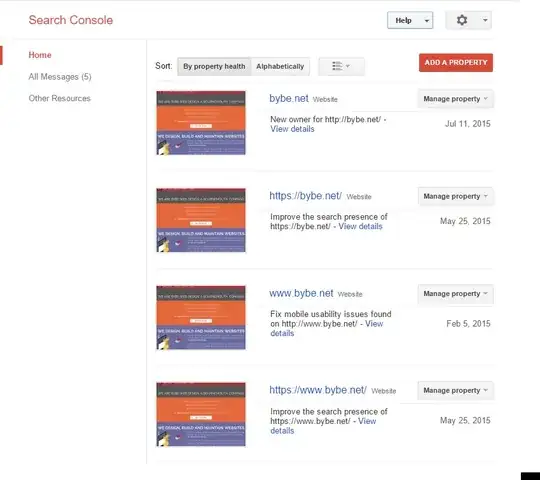

Add all variations of your site to WMT
While the site address move tool may not treat protocols, url changes and sub domains as new sites, the rest of Webmaster Tools does treat protocols and sub domains as separate sites. You should add all variations of your site, below is an example of my site BYBE added to WMT with all variations, you should do the same. (recommended by John Mueller from Google, See comments below this answer).
bybe multiple sites in webmaster tools
(source: bybe.net)
