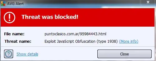

AVG Report Code that is being injected to my pages

  • It's a VPS, using Cpanel / WHM. Yes, that is the iframe (the code underneath the avg window here, I think you can see it better here: http://i.stack.imgur.com/1vkCv.jpg – Spiros Jul 22 '12 at 16:15
