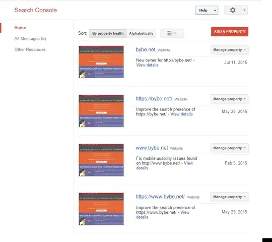

Why preferred domain in Google Console
It is a good practice to add all variations to Google Webmaster Tools so that you can confirm at any point that your site or Google is not doing anything it shouldn't be.
  • NON-SSL sites will have 2 variations
  • SSL sites will have 4 variations
You should seem something similar to this:
bybe multiple sites in webmaster tools
(source: bybe.net)
Adding a preferred domain in the process takes no more than a few seconds but in additional to 301 and canonicals this option is a great fallback just in case for some reason your 301's or canonical links stop working for one reason or more.
