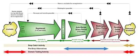

No. (And you have to be careful how you read things depending on where you look, to clearly understand the difference between registry expiration date and registrar expiration date; if you are not sure, this other answer from me can help too: https://serverfault.com/a/885149/396475).
It depends on the registrar, which you don't state. And it has nothing to do with status clientTransferProhibited.
TL;DR: it can be between 30+5 (35) days after expiration up to almost 45+30+5 (80) days after expiration, and add even some extra days in the worst case. Those are typical numbers for most gTLDs, but some may use other periods (the period length itself is not an ICANN requirement; having the period itself is a requirement, so once a domain is expired it goes into autoRenewPeriod then if it is deleted it goes to redemptionPeriod then pendingDelete).

Also mandatory disclaimer: while your case is not clear, it is NEVER recommended to wait for a domain to expire. If it is yours, renew it (even if you want to change registrars). If it is not, be aware that they are programs at various registrars that will register it as soon as possible (for a fee and/or an auction), so you won't have any chance manually to get it before them (so if you want it, it might be wiser to try to buy it from its current owner).
