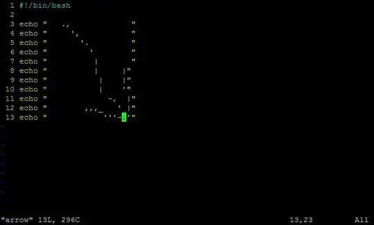

I can press:
to take my cursor to the position of last edit but:
doesn't take me to the last position of my cursor, as it says it should in the question / answer linked above.
There is also `` which will bring you back to where the cursor was before you made your last jump.
Insane
  • 153
That link addresses a different use case so it only partially applies.
  1. The "single quote" and "single backtick" marks are not saved between sessions so there's no reason to expect `` to work its magic in your specific example.
  2. `` moves the cursor to the position before the last "jump". Since you are moving your cursor with the arrows or hjkl there's no "jump" involved and thus no reason to expect `` to work its magic in the current session anyway.
  3. Contrary to the "single quote" and "single backtick" marks, the "dot" mark is saved between sessions so
    will effectively work within the current session and in future session.
  4. The "move to last position" mark you are looking for is the "double quote". Like the "dot" mark it is saved between sessions and can be used at any time:
