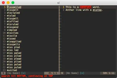

As @statox suggested, you can use the plugin I wrote: vimcorrect.
I'll explain basically how it works, so if you want to reuse some part of it, you can.
To focus on the next misspelled word I use directly ]s and [s as they jump to the next/previous match. I defined a custom match function to highlight the current word:
matchadd('error', '\%'.line('.').'l'.'\%'.col('.').'c'.s:current_word)
Which add to the match group error the current word at the current line/column (to prevent multiple matching on the same line).
The spellbadword() function return a list of possible correction for the word under the cursor.
I simply display this list in a buffer, and I map <CR> to replace the misspelled word by the current line (i.e. a possible corrected word).
I also map n and N to ]s and [s, as I am used to press them to search.
q is mapped to quit the plugin, close the split and remove the highlight.
Note: it's still highly unstable, but I plan on making some change soon. If you feel like you can/want to improve this plugin, feel free to fork/open a pull request.

  " Get suggestions for the current word
  let s:current_word = l:current_word[0]
  let l:suggestions = spellsuggest(expand(s:current_word))
  " If the current word present no spelling suggestions, pass
  if len(suggestions) <= 0
    return
  endif
  " Replace the word with suggestion
  silent execute "normal! ce" . l:suggestions[s:last_spell_changedtick[l:line][l:col]]
  normal! b
  " Increment the count
  let s:last_spell_changedtick[l:line][l:col] = s:last_spell_changedtick[l:line][l:col] + 1
endfunction
function! LoopConfirm()
  let s:last_spell_changedtick = {}
endfunction
nnoremap zz :call LoopSpell()<CR>
nnoremap z= :call LoopConfirm()<CR>
The basic idea is to map every changed word to a line/column pair (so that it will not work only for one element) and check whether the element had already been modified.
To do the replace, it's pretty much what my plugin does:
  • fetch the current misspelled word
  • check if corrections exists
  • replace word with corrected suggestion
When using this, if you want to go back to the misspelled word you can simply press u.
The LoopConfirm function reset the dictionary, so if you change your text, you can call it to prevent collisions.
Let me know if you run into any issue/if you have questions.
