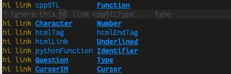

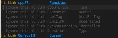

What I do to achieve this is to make a visual rectangular selection with Ctrl-V at the place where I want to add the prefix, and once all lines are selected, just press I (that's a capital i) and type in the text. When exiting insert mode the text will be copied to all the lines.
This is the sequence in images:
  • Visual selection of the place of insertion
vim1
  • Type in the text
vim2
  • Back to normal mode and the insertion is done
vim3
Note that this works anywhere, not only at the beginning of the line.
