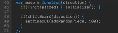

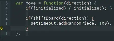

In Sublime Text 2, you get vertical guides where your indentation is, like this:
Sublime Text screenshot

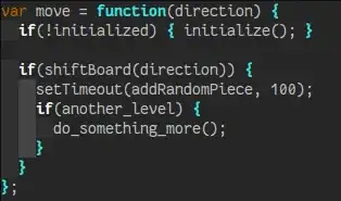

but Vim doesn't:
vim screenshot
Is there a way to show lines like that in Vim?
By the way, my indentation is 2 spaces.

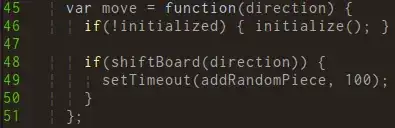

Vaibhav Sagar points out the plugin indentLine performs this functionality.
Install in the normal way (see installing Plugins) and it seems to magically just work without further input. If you don't mind the ASCII bars, you don't need to do anything with your fonts. Example output of your example after setting your indentation settings and running :IndentLinesReset
45   ¦ var move = function(direction) {
46   ¦ ¦ if(!initialized) { initialize(); }
47
48   ¦ ¦ if(shiftBoard(direction)) {
49   ¦ ¦ ¦ setTimeout(addRandomPiece, 100);
50   ¦ ¦ }
51   ¦ };
screenshot of example with spaces
The plugin requires Vim 7.3 or later, and makes cleaver use of that version's Conceal feature. Instead of actually hiding text, it replaces text with bars in the view, but not the actual buffer. The result is you see the bars but they don't get saved into the file (since they are actually spaces)
