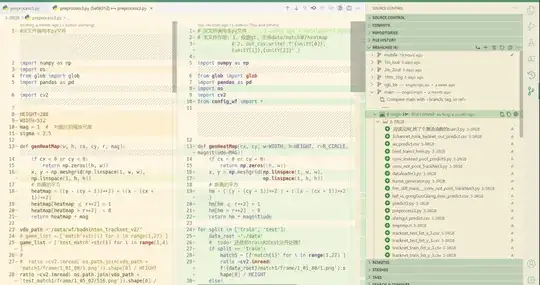

I think using vscode-neovim to handle git diff is more convenient.
Using the GUI is convenient to compare between branches, commits and so on.
vscode-neovim give you almost the same (or 90%?) experience of original neovim, using most part of its vimrc(init.vim), unlike vscode's vim extension, which is not so "vim"
Good Pen
  • 211
    This may not actually answer the question, as vscode is not Vim? The answer also does not provide enough details on how to use Vim as a diff tool (a sentence about your preference and a screenshot are not enough; the answer would benefit from specific steps). You can [edit] this answer to improve it – D. Ben Knoble Feb 17 '22 at 18:18
