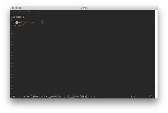

You can also use Vim's built-in "include-search" functionality: press [i to print the "signature" of the word under the cursor in the command-line:
[i
See :help include-search.

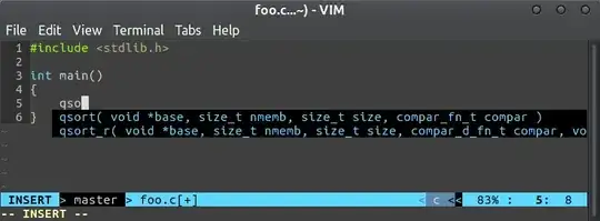

Vim's C/C++ file type comes with a decent omnicompletion function, which supports "preview" functionality. So add "preview" to your completeopt option and see a function signature when you do insert mode completion.
In normal mode, you could CTRL+W } to open the function declaration in the preview window manually.
