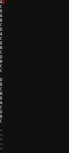

I am working on a ChromeOS computer with both Vi and Vim. When I open up the editor to an existing document, I type A to begin editing. When I try to move around with my arrow keys, the following happens:
vim and vi arrow keys
I have tried both Vim and Vi, and both of the have this problem. How do I move around in my document while editing it?
