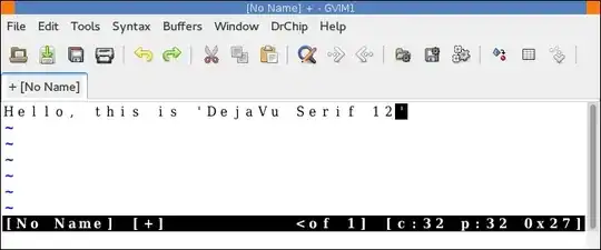

I tried changing the font for gVim with:
:set guifont=Dejavu\ Serif\ 12
But this gives me some rather ugly results:
I get the same results if I use the menu (Edit -> Select font)
:help guifont says:
Note that the fonts must be mono-spaced (all characters have the same
width).  An exception is GTK 2: all fonts are accepted, but
mono-spaced fonts look best.
So I think the above results count as "not looking best"? Can this be improved upon, somehow?

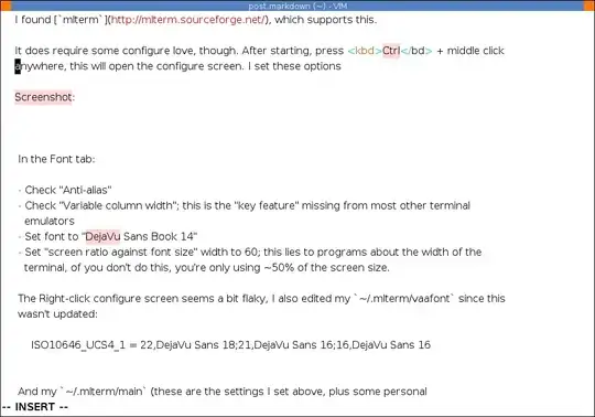

I found mlterm, which supports this. Aside from Emacs' built-in terminal (M-x term) this is the only terminal I've found that supports this (I've tried about 15-20 different ones).
I've found that mlterm works better than Emacs due to the sceen ratio settings, and you also avoid having to run Vim inside an Emacs session (I'm not even sure that is legally allowed).
Screenshot (it looks ugly unless you open it full size due to scaling in the browser):
It does require some configure love, though. After starting, press Ctrl + middle click anywhere, this will open the configure screen. I set these options
In the Font tab:
  • Check "Anti-alias"
  • Check "Variable column width"; this is the "key feature" missing from most other terminal emulators
  • Set font to "DejaVu Sans Book 16" (or whatever else you prefer)
  • Set "screen ratio against font size" width to 60; this lies to programs about the width of the terminal, of you don't do this, you're only using ~50% of the screen size. The best value for this depends on the font used, so experiment a bit...
The Right-click configure screen seems a bit flaky, I also edited my ~/.mlterm/vaafont since this wasn't updated:
ISO10646_UCS4_1 = 22,DejaVu Sans 18;21,DejaVu Sans 16;16,DejaVu Sans 16
And my ~/.mlterm/main (these are the settings I set above, plus some personal preferences):
type_engine = xft
bel_mode = none
scrollbar_mode = none
fontsize = 22
use_anti_alias = true
use_variable_column_width = true
line_space = 5
use_multi_column_char = true
col_size_of_width_a = 1
screen_width_ratio = 50
There are some artefacts, which are to be expected, but writing emails or posts such as this, it seems to work quite well!
