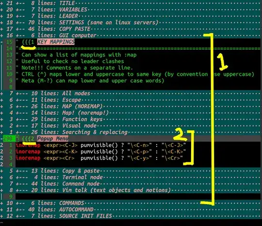

Folds
I used to separate my init.vim into many other files, but it makes startup a little bit (insignificantly?) slower, but the main thing is ones setup becomes very fragmented, and constantly have to switch buffers when working on config. I moved to using folds. Refer to :help usr_28 for help on folds. Search down in particular for the section *28.6* Folding with markers
I break apart my init file as shown below. It shows a level1 KEYMAPPINGS fold expanded. There are many level2 subsections (folds) such as map, map!, function keys, visual mode within the main level1 section. In the image a level2 fold is expanded (Popup Menu keymappings`).
Firstly to enable {{{ and style folds set these options:
set foldmethod=marker
set foldcolumn=1
I use the following code to highlight the Level1 and Level2 section headings of the folds. _FoldLevel1 and _FoldLevel2 are highlight groups defined next.
augroup match_folds
    autocmd!
    " VimEnter handles at start up, WinNew for each window created AFTER startup.
    " Regex matches { { { with an empty group in the middle so that vim does
    " not create a fold in this code, then either a 1 or 2 then a space. Then
    " zs is the start of the match which is the rest of the line then ze is
    " the end of the match. Refer to :help pattern-overview
    autocmd VimEnter,WinNew * let w:_foldlevel1_id = matchadd('_FoldLevel1', '{{\(\){1\ \zs.\+\ze', -1)
    autocmd VimEnter,WinNew * let w:_foldlevel2_id = matchadd('_FoldLevel2', '{{\(\){2\ \zs.\+\ze', -1)
augroup END
I style my folds with:
" {{{ Folds
hi Folded               guifg=#FF9999 guibg=#005050 gui=bold,italic
hi FoldColumn           guifg=#FF9999 guibg=#005050 gui=bold
hi _FoldLevel1          guifg=#005050 guibg=#FF9999 gui=bold,italic
hi _FoldLevel2          guifg=#003030 guibg=#CC8080 gui=bold,italic
Now place {{{1 to Create a level 1 esction, {{{2 to create a level 2 section: (I trimmed the file down, to a skeleton, normally each section is about a screen long).
" {{{1 GUI computer
set mouse=a                 " Enable use of the mouse for all modes
set number                  " Display line numbers on the left
set relativenumber
" {{{1 KEY MAPPINGS " Can show a list of mappings with :map " Note!!! Comments on a separate line.
" {{{2 All modes map ; : map! <M-;> <Esc>:
" {{{2 Map " Map backspace to other buffer noremap <BS> <C-^> noremap <BS> <C-^> " }}}2 <- OPTIONAL way to force closure of a section, if you want to create a blank line before the next section is automatically made with {{{1 or {{{2 etc
" {{{1 ANOTHER HEADING " More stuff
