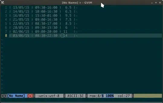

I'm writing down a markdown table which looks like this:
| 13/05/15 | 09:30-16:00 |  6.5 |
| 14/05/15 | 10:00-16:30 |  6.5 |
| 16/05/15 | 15:30-01:00 |  9.5 |
| 21/05/15 | 09:00-16:30 |  7.5 |
| 22/05/15 | 08:30-17:00 |  8.5 |
| 28/05/15 | 09:30-15:30 |  6   |
| 02/06/15 | 09:00-20:00 | 11   |
| 03/06/15 | 08:30-22:30 | 14   |
I'm looking for a way to quickly calculate the total of the third column and insert it in the buffer. The solution I have in mind would make use of visual-block mode (to select all the numbers) and maybe of the expression register (to do the math).
Would this be possible using native Vim commands? If not, is there a plugin that can help me?

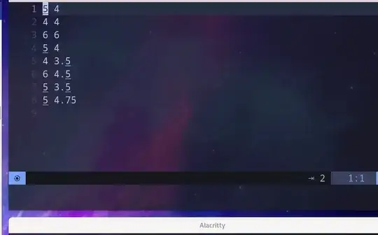

This is a way to do it: First, add the following to your .vimrc:
command! -range Add
    \ silent exec "norm gv\"ay" |
    \ let array = split(@a, "[\\n\\t ]\\+") |
    \ let sum = 0.00 |
    \ for item in array |
    \     let sum += str2float(item) |
    \ endfor |
    \ echo sum
then reload vim, and highlight a column of numbers in visual selection mode, and then type:
:'<,'>Add
and it will print out the sum of the numbers in the column.

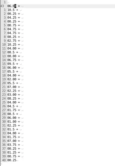

I just did it this way:
  • thru the block selection copied all values, as a column to a new buffer
  • quickly edited the text to construct a mathematical expression enter image description here
  • copy/pasted it to the default system calculator enter image description here
