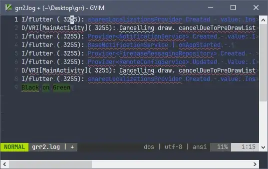

I believe your example lack the ^[ aka Esc character obtained by hitting Ctrl vEsc.
With these character inserted I have the following result:
For the following text:
I/flutter ( 3255): ^[[38;5;12msharedLocalizationsProvider Created - value: Instance of 'SharedLocalizationsSv'^[[0m
D/VRI[MainActivity]( 3255): Cancelling draw. cancelDueToPreDrawListener=true cancelDueToSync=false
I/flutter ( 3255): ^[[38;5;12mProvider<NotificationService> Created - value: Instance of 'NotificationService'^[[0m
I/flutter ( 3255): ^[[38;5;12mBaseNotificationService | onAppStarted - ^[[0m
I/flutter ( 3255): ^[[38;5;12mProvider<FirebaseMessagingRepository> Created - value: Instance of 'FirebaseMessagingRepository'^[[0m
I/flutter ( 3255): ^[[38;5;12mProvider<RemoteConfigService> Updated - Value: Instance of 'RemoteConfigService'^[[0m
^[[30;48;5;22mBlack on Green^[[m
Where ^[ again are the Esc character obtained by hitting Ctrl vEsc.
Remark: I inserted them in your text by running:
:%s/\[\d\+/^[&/g
Where ^[ is obtained by hitting Ctrl vEsc :-)

  • Does this still work when you :set termguicolors as OP wrote in his update 2? To me, it seems the original problem was not the escapes or the plugin but ANSI escapes with termguicolors. – Friedrich Feb 27 '24 at 10:33
    On gVim it works whatever the value of termguicolors on Vim and nvim it is indeed only working is off (:set notermguicolors) and it seems that on nvim-qt it doesn't work whatever the value of termguicolors. – Vivian De Smedt Feb 27 '24 at 11:11
    Thanks, you confirm what OP writes. Based on :help termguicolors I would not assume it to have any effect in a GUI version. Now the question remains: can we have termguicolors and ANSI color escapes or are they mutually exclusive? I don't know and I'd be in favor of setting notermguicolors (the default). – Friedrich Feb 27 '24 at 12:05
    Thanks for your reply, and for confirming that :set termguicolors doesn't work. I just noticed that the correct escape codes were removed when I posted. It is actually correct in nvim. I might just look for an alternative to the plugin instead. – Hannes Hultergård Feb 27 '24 at 18:08
