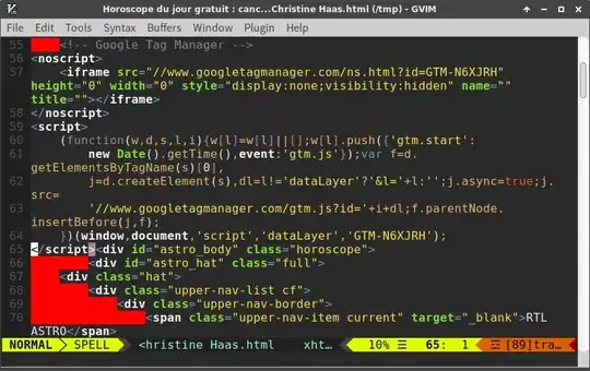

Permanent Tab highlighting
" Highlight tabs as errors.
" https://vi.stackexchange.com/a/9353/3168
match Error /\t/
Tab highlighting in vim
More highlighting
For more of these useful highlighting commands —including combined with trailing whitespace and making this permanent— see the Vim wiki.

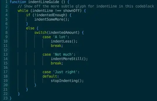

I personally like the use of the plugin indentLine, which displays a vertical line at indentation levels.
It is of great help especially in python, where the indentation is important.
(Image taken from the link above)
Among other things, it provides a toggle command, that can be mapped to a key combination, so that you can turn it off, when you don't need it.

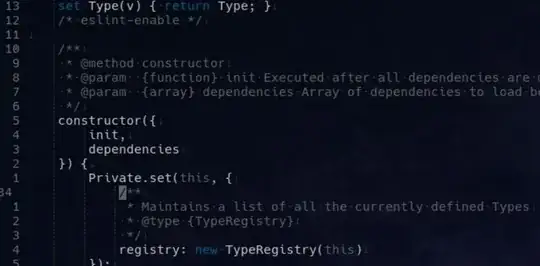

This can be easily achieved using listchars by specifying the tab as: ,tab:\ \ ┊,
By providing two escaped spaces in front of your tab declaration, vim will repeat the spaces. This is opposed to the default, where vim prefers the second character as the repeating character.
This achieves a similar effect to using a plugin like IndentLine without the overhead. Here's an example of what it might look like using the following complete listchars config:
set listchars=eol:↓,tab:\ \ ┊,trail:●,extends:…,precedes:…,space:·
source code
Swivel
  • 151

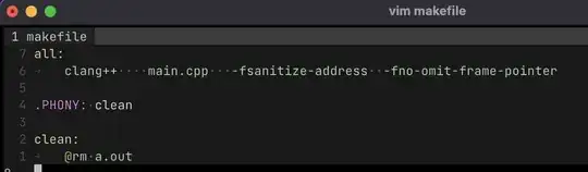

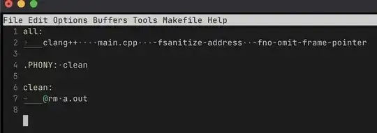

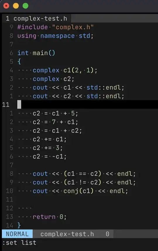

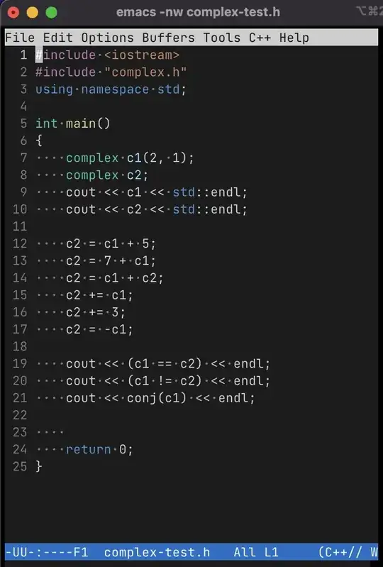

I like VSCode's "render whitespace" display
I customize vim's space and tab chars like vscode, i.e. use dark gray color dot for space char, use arrow char for tab.
My vim configuration
"\u21A6 is ⇥
"set listchars=eol:$,tab:⇥¬¬,trail:·,extends:>,precedes:<,space:·
" 0x1F862 is
" https://vi.stackexchange.com/questions/422/displaying-tabs-as-characters
set listchars=tab:\ ,trail:·,extends:>,precedes:<,space:·
" Set the list char color
" https://vi.stackexchange.com/questions/6136/how-to-dim-characters-from-set-list/6140#6140
" :hi SpecialKey ctermfg=grey guifg=grey50
" https://gist.github.com/morumo/9405368
:hi SpecialKey ctermfg=darkgray guifg=gray70
My emacs configuration
Btw, I also tried to configure the render display in my emacs configuration:
;; https://github.com/jameshintaro/.emacs/
;;http://ergoemacs.org/emacs/whitespace-mode.html
(require 'whitespace)
(setq whitespace-style
      '(face tabs tab-mark spaces space-mark))
(setq whitespace-display-mappings '( (space-mark ?\u3000 [?□]) ; 全角スペース (space-mark ?\u0020 [?\xB7]) ; 半角スペース (newline-mark ?\n [?$ ?\n]) ; 改行記号 ;(tab-mark ?\t [?\x2192 ?\t]) ; tab (tab-mark ?\t [?\x1F862 ?\t]) ; tab ) )
(setq whitespace-space-regexp "\([\x0020\x3000]+\)" )
;(set-face-foreground 'whitespace-space "Goldenrod1") (set-face-foreground 'whitespace-space "Azure4") (set-face-background 'whitespace-space 'nil) (set-face-bold-p 'whitespace-space t)
;;(set-face-foreground 'whitespace-tab "DarkOliveGreen1") (set-face-foreground 'whitespace-tab "Azure4") (set-face-background 'whitespace-tab nil) (set-face-underline 'whitespace-tab t)
;;(set-face-foreground 'whitespace-newline "DimGray") ;;(set-face-background 'whitespace-newline 'nil)
Which looks like the following: enter image description here
