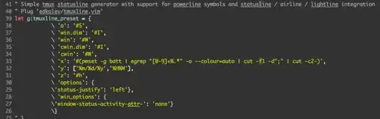

In my vimrc I have this line :
call matchadd('ColorColumn', '\%81v', 100)
It colors the 81th column in a subtle grey background so I can track my line length :
(see the l and the f)
I found out that when editing a large file, this function causes Vim to be very slow.
One of the file I am currently working on is a jsp file with a lot of mistakes in the indentation/syntax.

  • I can't really answer that, but check :h colorcolumn, this is a standard option for vim. The help states "Will make screen redrawing slower.", so you won't probably get around that, but maybe the internal implementation is atleast faster then your version. – PhilippFrank Aug 04 '15 at 09:32
  • with a set cc=+1 and a set textwidth=80 I get the 81th column colored with no performance issue, so I'll stick to that for the moment, thanks for the advice – nobe4 Aug 04 '15 at 09:45
Try appending the \%#=1 to the pattern so the old regexp engine is used. If I remember correctly, there was a bug in the newer engine that makes matching column positions slower, which was fixed later in the 7.4. development.
