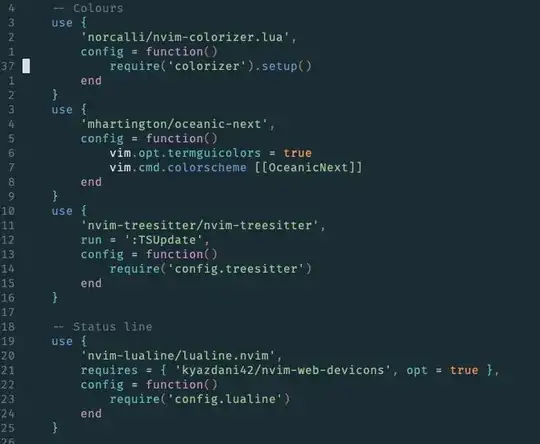

I have just migrated my nvim setup to all Lua and changed some plugins.
I have added nvim-treesitter and tried a few themes. The themes change OK and get applied, but there's something off with the colors, and I have no idea why. I can't find any config which affects it.
It might not even be a Neovim problem because when I open nvim in Terminal instead of iTerm the background is just all yellow and highlighting doesn't seem to work (or is that because it doesn't support those colors?).
dotfiles: https://github.com/MrMatten/dotfiles
iTerm, tmux, nvim
packer, treesitter, oceanic-next enter image description here

  • I would start with How to debug my vimrc and just trim down as much as you can to a minimal setup and try to reproduce or fix the problem – D. Ben Knoble Nov 14 '22 at 16:32
  • I have actually done that but forgot to update my question. It seems it's nvim-treesitter that messes with colors. I still need to do some further research though. I will update after I have tested again – Mr Matten Nov 16 '22 at 05:34
I hit the same issue when I have set termguicolors (vim.o.termguicolors = true). It can be fixed with set notermguicolors (vim.o.termguicolors = false).

This ended up having nothing to do with a plugin or anything else Lua related.
iTerm2 was affecting the colorschemes even though I have tried with termguicolors on/off.
I have now changed to Alacritty to try something else.
