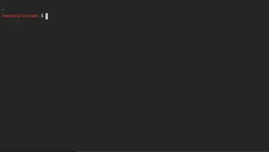

$ vim http://example.com/
doesn't download anything so your buffer is empty and the search reaches the end of the buffer without finding anything.
On the other hand,
$ vim http://example.com/index.html
actually downloads a file and populates the buffer, which allows you to search for <head>:
/<head>
find the first line containing that pattern, make it the current line and print it.
Ex mode
There's nothing complicated, here.
