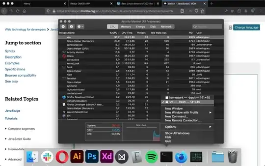

I've come to realize that sometimes, even after :q and quitting the terminal, there is a Vim process hung on background that I can not pinpoint where it comes from. I've tried to reproduce the process forcefully, but it never happens when I want. It happens when it happens, and I only realize bc my computer starts overheating and the fans get going on.
Any Idea why that might be? has this happened to any of you before? I sincerely don't know what to do.
Here is a screenshot of the last occurrence, it has happen about five times in the last month. I noticed the overheating, and left the terminal open on purpose so I could demonstrate that all windows were not running processes.
Restarting the system has no apparent influence on it. Running react app servers with npm start, seems to have some influence on it, but it might be wrong correlation since I've meen doing that whilst coding on vim.
Vim hung on background
