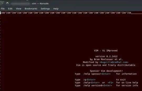

function! GitBranch()
  return system("git rev-parse --abbrev-ref HEAD 2>/dev/null | tr -d '\n'")
endfunction
function! StatuslineGit()
  let l:branchname = GitBranch()
  return strlen(l:branchname) > 0?'  '.l:branchname.' ':''
endfunction
set laststatus=2
set statusline+=%#PmenuSel#
set statusline+=%{StatuslineGit()}
I have the code above on .vimrc, which shows git branch status on statusline, it works well until I start scrolling to the top or bottom of the page, strange output appearing on my Konsole screen like this,
Anyone know why?
:help system() tells you about this:
system({expr} [, {input}])              *system()* *E677*
    When prepended by |:silent| the terminal will not be set to
    cooked mode.  This is meant to be used for commands that do
    not need the user to type.  It avoids stray characters showing
    up on the screen which require |CTRL-L| to remove. >
        :silent let f = system('ls *.vim')
So call system() with silent seems to avoid this issue.
However, putting that aside, calling an external process on every statusline update doesn't seem like a very swell idea to begin with. Starting up an external process is slow and statusline is called very frequently when scrolling. Try adding :silent and you'll see that while it makes the stray characters go away, scrolling becomes unbearably slow as vim queues its input and wait for the system call to finish.
I'd recommend caching the external call in a g: variable and only making a real call every now and then, it's not like you'll be changing branch every second or so.

^[ is a representation of <Esc>, the escape key. When you scroll up or down using your mouse or trackpad, your OS sends an escape code to the terminal. <Esc>OA and <Esc>OB are the escape codes for Up and Down. The escape codes for Right and Left are <Esc>OC and <Esc>OD.
Kinda annoying that you're seeing this instead of a more graceful failure to scroll, but such is life :)
Ari Sweedler
  • 772
  • is there a way to tell VIM to ignore it once it reach top and the bottom of the page? – Thomas G. Lau Aug 28 '20 at 01:19
  • @ThomasG.Lau I do not know of a way for this to happen. Vim shouldn’t even be displaying these, as far as I know. This is a very in-the-weeds issue to debug. Maybe a Jacky workaround will save you. Maybe you can try remapping - map <esc>OA <Up>. No idea if that’ll fix anything. – Ari Sweedler Aug 28 '20 at 01:21
  • @ThomasG.Lau I wonder if it is Vin’s fault or your terminals fault. Does this issue only happen with vim for you? You must diagnose where the problem is then treat it accordingly. I am down to help you a little bit, but this probably isn’t the site to do this on :P – Ari Sweedler Aug 28 '20 at 01:22
  • without the script above, VIM act normally, that's all I can tell you – Thomas G. Lau Aug 28 '20 at 01:29
