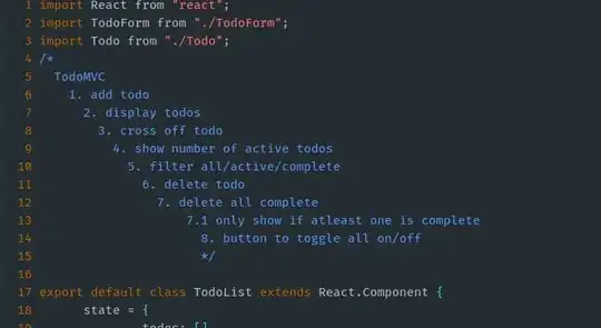

I copied this file to vim and enumerated items got weird staircase pattern indent. Why so and how can I prevent this text corruption on a copy? It seems that it happens not only with enumerated items but rather in general every time I am copying some text it gets corrupted in Vim.

The reason why you get this "staircase" effect when pasting is that you have settings that will cause Vim to want to auto-indent this block, but the text you paste has indentation itself.
So every time a line break goes through the paste, Vim will copy the indentation from the line above, but then your paste will introduce another set of spaces/tabs from the indentation of the original document.
Another common artifact from pasting into a document is that Vim might want to rewrap long lines, especially when the 'textwidth' option is set.
The 'paste' option exists exactly for this use case, while 'paste' is enable, Vim masks the behavior of a handful of options, such as 'autoindent', 'textwidth' and 'formatoptions', among others, so that the interference with text coming from a paste is kept to a minimum. It also disables insert mode mappings and abbreviations.
