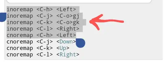

The problem is that you have a trailing space in your inoremap line in your vimrc.
That trailing space becomes part of the mapping replacement, so every time you type <C-h>, not only will Vim execute the <C-o>gk part, which will move up one line, it will also produce a <Space> in Insert mode.
I can actually even see it in your paste in your question...
Screenshot with selection.
If you enable :set list while looking at your vimrc, this is what you'll see:
inoremap <C-h> <Left>$
inoremap <C-j> <C-o>gj$
inoremap <C-k> <C-o>gk $
inoremap <C-l> <Right>$
See the trailing space there?
Also if you use :imap or :imap <C-k> to inspect the definition of the mapping, the trailing space will be displayed as <Space>, which will also make it obvious:
:imap <C-h>
i  <C-K>         <C-O>gk<Space>
Simply remove the trailing space from your mapping definition and it will work as expected.
