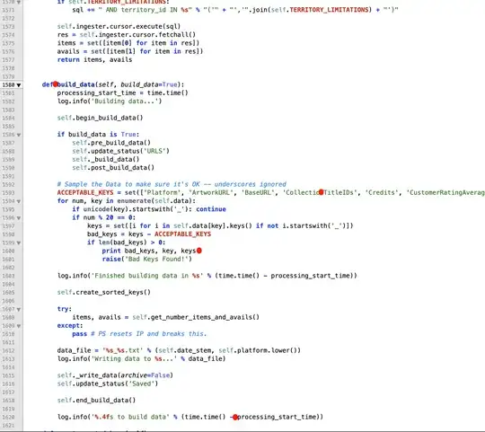

Is it possible for vim navigation to be as quick as a normal point-and-click navigation? For example, I've taken the following example here where I've created four points that need to be clicked:
Without any practice or thinking, I'm able to click those four points in 3.9 seconds, video here. What would be the fastest that someone could get to those four locations in vim? I mean if someone were not to "think about it", i.e., just given four random points spaced across a screen what would be the fastest way to get there (fastest, as in lowest amount of time, not fewest keystrokes)?
I am a vim beginner, and my first attempt took about 40s (!!) -- https://gyazo.com/377ca4a30a12c0814ad8b6255b761075. Mostly due to trying to do a search and it basically starting from the top of the document every time. What would be some ways that this can be improved? Note: it seems like I had a bad search option (it was starting from the top of the file), so when I fixed that I was able to click the four points in about ~13.5s.
If helpful, here's the method if someone wants to use that for their answer (can insert ~1500 blank lines above the method):

I'd like to primarily challenge the premise of your question/challenge/race:
When you're editing text, you're not only moving to specific locations on the text, you're moving to those points and adding or modifying text there, before moving on to the next location and editing that one.
The claim that using keyboard commands in Vim allow someone to edit code faster than someone who only has a mouse (and arrow keys) is essentially about how moving your hand between keyboard and mouse constantly takes significant time and breaks/interrupts your flow, while keeping your hands on the keyboard while alternating between motion (normal-mode) and editing (insert-mode) can be more efficient for many common editing tasks.
You typically don't move to random points on the text while editing. In general, you're moving between related parts of the text while performing edits. For example, if you're refactoring code, you're looking at all uses of the same variable or all calls of a specific function. If you're writing new code, you're typically just working on one (or a few) short blocks of code.
That assumes that all the locations you are jumping to can fit in one screen and that's rarely the case.
One of the typical cases where mouse-based navigation quickly breaks down is when the locations you want to jump too are off the screen and you need to scroll.
Using logical (move to next paragraph, or next function, or next class, or next occurrence of the word under the cursor, etc.) rather than physical (point-and-click) motions help with moving to the locations you want, even if you don't necessarily see them on the current screen.
You can use the mouse in Vim, even on the terminal. There are many times where "using a mouse" is the right answer and nothing really precludes the use of the mouse in Vim.
what would be the fastest way to get there (fastest, as in lowest amount of time, not fewest keystrokes)? I am a vim beginner, and my first attempt took about 40s (!!) -
Learning more motions definitely helps!
It can take a long time to really master Vim motion commands and be super effective with them.
My advice is next time you find yourself having trouble jumping to a specific point in the text, take a break and try to think hard about it. What's the conceptual nature of this motion? Is it generic enough? How does it relate to the programming language this file is written in?
Then try to find/research motions that will get you there quickly. That might involve searching for them in :help, looking for motion plug-ins that can help, looking for plug-ins that improve handling of the file type you're editing, or even asking on this site how one would move from A to B most efficiently.
The upside of this learning process is that next time you need the same kind of motion, you will know one that works (or at least gets you closer quicker.) With time, you'll be able to move there quickly without really thinking about it. It takes effort to create habits, but once you have them, deploying them is easy.

    "I recorded my screen using Textmate and Vim and found that (with my basic skillset) I'm able to do the editing at around the same speed -- it's the navigation for me that is so much slower. So I'm trying to benchmark and optimize that." But if you read my answer again you'll see that the claim that you can be faster/more efficient in Vim is about how it's easier to switch from motion to editing, while with a point-and-click approach that involves switching from mouse to keyboard and that's the inefficient part... Comparing motion only by itself is unlikely to give you best results... – filbranden Apr 24 '20 at 03:27
FWIW, I tried it out, and without thinking about it, this is what I ended up typing:
  1. /def<CR>w
  2. /Tit<CR>
  3. /print<CR>$
  4. /- p<CR>nw.
I was a little unclear as to whether you wanted the cursor exactly on the red dots, or on the more significant characters next to the dots. If I guessed wrong, there may be slight adjustments required to the above.
In real life, I almost definitely wouldn't have actually used search for all of these, but since you primed me with "jump fast to a bunch of arbitrary positions on screen" I was predisposed to do so: search is very often the quickest method for moving to a position that is conceptually unrelated to my current position.
I didn't time it, but the vast majority of my time was spent looking back at your picture to find where the next red dot was. I'd be amazed if I could do this quicker with the mouse presuming I also had to move my hands back and forth between the keyboard and mouse between every movement (which I would do if I were editing code at each position: as others have stated, if you're not performing edits, there's no reason to move the cursor).
If I weren't performing edits and were instead just randomly moving the cursor around (for fun?) then I'd probably be slightly quicker with the mouse, but if I were a better typist, I doubt I still would be for this test.

Here's what i did to reach the 4 points:
Given I start from the 1st point,
  • /Coll<ENTER>tT
    Just basic searching, and then using t to reach the next occurrence of a specific character on the same line.
  • 1600G
    Move to the line number 1600, The cursor is already a the end of the line. It might be easier if you have the option relativenumber set, so that you can hit 7j or 7<DOWN>
  • GB
    The G brings me to the end of the last line, and B, to the first white space preceding the cursor.
I was able to do this in around 5 seconds.
That's my flow without thinking, but there are a thousand ways to do those moves, and half of them would be faster than what I did I'm sure!
Here are some other that I usually use:
  • H, M and L to go to the top, middle and bottom of the current view
  • [( and ]) to go to the beginning / end of the current paragraph
  • [{ and ]} to go to the opening brace before the cursor, or closing after the cursor (useless with a language like python)
