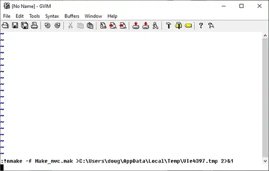

  3. You can see !nmake -f Make-mvc.make > C:\Users\doug\AppData\Local\Temp\VIe4397.tmp 2>&1 appear in the vim command line window, but no other output appears until the command completes.
    Running :make -f Make_mvc.make
