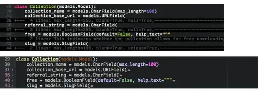

I'm a fan of the way that Atom and Sublime Text handle line folding, where the first line of each fold is visible (complete with syntax highlighting), and a marker is appended to the end of the line that indicates the fold.
See the screenshot below comparing Vim's indent folding (top) versus Atom's (bottom):Vim vs. Atom code folding
Vim dedicates two lines for each fold. The first line serves as a heading, and the second line describes some information about the fold (number of lines and text inside the fold).
Atom only uses one line, and uses a small marker at the end of the line to indicate the fold, along with color added to the line numbers on the left. Atom's folding style uses less screen real estate but still communicates all the information I really need.
I'm partial to the Atom folding style. It seems cleaner and more consistent, in my opinion, particularly when listing multiple methods or attributes in a row (as in the above screenshot).
Is there a way to roughly approximate Atom's folding style in Vim?

    I think it's because your folds don't actually begin with with the line containing the opening brackets. Vim only uses the fold text on the line where the fold begins. See, for example, how brace placement affects it in C: http://imgur.com/3h70dPf,wfCLPm7 – muru Feb 24 '15 at 06:07
  • But this is Python, no braces involved (from __future__ import braces)... How did you configure folding? And can you paste this code snippet (or another that demonstrates the problem)? Vim folds to a single line, but as muru mentioned, your folds start a line late. – Martin Tournoij Feb 24 '15 at 08:16
  • @Carpetsmoker the braces are only for illustration of where the fold starts. The same effect can be seen on, say, Haskell. – muru Feb 24 '15 at 08:46

Two lines vs. one line
In Vim, all lines within a fold will be collapsed to a single line, and the 'foldtext' option then determines the synopsis of those lines (usually dashes, the number of folded lines, and content from the first (or all) lines).
In your example, in Vim only the {...} parameter block itself is folded; the line above (that uses the parameters) isn't part of the fold. In contrast, in the other editor, that line using the parameters belongs to the fold, and its foldtext (to use Vim terminology) is the contents of that line plus the appended marker.
Adapting
In Vim, folds can be generated via different means (see :help fold-methods), and depends on the 'filetype' of the buffer. The difficulty of including the above line in the fold depends on that; check with :setlocal foldmethod?. With indent folding, there's nothing you can influence; you have to switch to another method. For syntax folding, that would mean adapting the syntax definitions, and could be very tricky. You'll have better luck if an expression is used, but it would still mean understanding and changing the logic. (It's unlikely that the filetype plugin author provided a configuration to influence this.)
Syntax highlighting of the folded line
That unfortunately isn't possible at all. Vim always uses the Folded highlight group for the entire folded line. You can tweak that via :highlight commands in your ~/.vimrc, but the individual differentiation of syntax will be lost.

Vim already displays folds as a single line. However, in Vim's indent folding, all the lines that have the same indent are included in a fold. So in your screenshot, the lines you are referring to as "headers" (e.g., the one starting collection_base_url) are not within the folds.
You can achieve something similar to Atom's folding by using Vim's foldexpr foldmethod:

This defines a fold expression (see :help fold-expr) as follows:
  • For lines immediately preceding indented lines, it returns the indentation of the block that follows.
  • For indented lines, it returns the indentation. (Divided by the shiftwidth so each level of indentation increments the returned value by 1)
  • For lines at the end of a block of indented lines, it returns a string "<N", where N is set to the indent. This tells Vim that a fold of level N finishes on that line.
