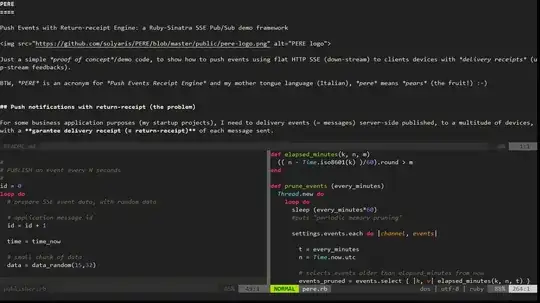

In alternative to the maximized window, why do not gain more space for a full vim multiwindows editing experience with an autostart FULL SCREEN mode? ;-)
FULL SCREEN screenshot of the final result (= ALL THE VIDEO pixels capacity): video full screen screenshot
In my opinion that's better than a windows maximize: a complete FULL SCREEN (as I used to do with puTTY with ALT-Enter when editing on remote unix terminal...)
I explain how to:
Step 1
Install the excellent beautiful utility to allow full screen use in gvim on Windows:
https://github.com/derekmcloughlin/gvimfullscreen_win32/tree/master
You have to download DLL file gvimfullscreen.dll and put it in the same directory where gvim.exe is ($VIM/vim74 with gVim release 7.4). To download the DLL (without using git):
https://github.com/derekmcloughlin/gvimfullscreen_win32/raw/master/gvimfullscreen.dll
Step 2
Edit .vimrc file (inside vim: :e $HOME/.vimrc), inserting these commands to autostart full screen and allowing a F11 function key to toggle modes among 3 states: full screen, window maximized, original/default windows size:
"run the command immediately when starting vim
autocmd VimEnter * call libcallnr("gvimfullscreen.dll", "ToggleFullScreen", 0)
" activate/deactivate full screen with function key <F11>
map <F11> <Esc>:call libcallnr("gvimfullscreen.dll", "ToggleFullScreen", 0)<CR>
Step 3
Edit .gvimrc file (inside vim: :split $HOME/.gvimrc) inserting these commands to avoid menu bar and useless stuff:
set guioptions-=m  "remove menu bar
set guioptions-=T  "remove toolbar
set guioptions-=r  "remove right-hand scroll bar
set guioptions-=L  "remove left-hand scroll bar
Giorgio Robino
