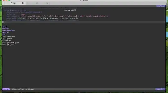

Problem
Anytime I switch to a colorscheme the background turns this ugly gray that gives everything a washed out look. Why does this happen, and how can I prevent it?
Example screenshot—
Dracula scheme
More details
This does not appear to happen when using agude/vim-eldar.
The :hi reports are below for vim-eldar—
:verbose hi Normal Normal xxx         guifg=White guibg=Black
    Last set from ~/.local/share/nvim/plugged/vim-eldar/colors/eldar.vim
and Dracula—
:verbose hi Normal Normal xxx         ctermfg=255 ctermbg=236 guifg=#F8F8F2 guibg=#282A36
    Last set from ~/.local/share/nvim/plugged/vim/colors/Dracula.vim

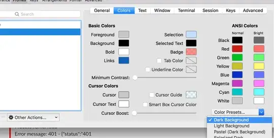

  1. make sure terminal color is set to xterm-256 color
  2. :set background=dark
My iTerm2 color preset is dark background
iTerm2 prefs

More than likely, it comes from a colorscheme using the Normal highlighting group (:help :hi-normal-cterm).
Essentially, as mentioned in the chat conversation, some colorschemes do something like :hi Normal ctermbg=... to change the color of the background of the terminal inside vim. This was happening for Dracula (and, as you noticed, it's not pretty. More on that in a second), and Molokai as well.
How do I fix it?
I'm going to address this on a case-by-case basis, then give some broader options.
Dracula
It came up in the chat that the OP was using Dracula. As I mentioned here, during a theme overhaul some issues were raised about the theme background.
It was using a 256-color approximation of the right color when it couldn't use truecolor (like a GUI hexcode). We added in a way to disable this, restoring the terminal background color.
Put this
let g:dracula_colorterm = 1
before colorscheme dracula to use your own terminal background.
