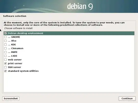

You should be able to use the DVD1 you already downloaded, instead of doing a netinstall, although immediately do an update. (Only DVD1 is bootable, the others are used as Repositories.)
Untick everything except the bottom one "standard system utilities".
