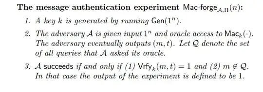

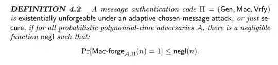

I have this:
\usepackage{picins}
\shadowthickness{2pt}
\newcommand{\sidenote}[1]{
    \begin{center}
    \hpic(0.95\textwidth,0pt)[rs]{
        \parbox[b]{0.9\textwidth}{\small
             \bigskip{#1}\bigskip
    \end{center}
Which generates a nice (shadowed) box with padding. The problem is that \sidenote cannot accept formatted text (i.e. paragraphs).
Is it possible to define a "FancyRemark" environment which has the same visual style but does allow for paragraphs and display style math?
