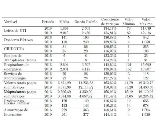

My objective was to write latex code for the following table created in Word. enter image description here
However, I am unable to format the first column. I would like to define a certain measurement for the column width and for this command to generate an automatic line wrap if the width is too small and in addition, I would like the text to be centered between the two cells that were merged.

As mentioned in the comments, I tried to solve the problem using the command \multirow{2}{=}{...}
but this generated some overlapping of the lines as you can see in the Figure below.

  • In the fourth and fifth row, you use \multirow{2}{=}{Doadores Efetivos}, that is, you use = instead of *, which seems to work fine. Why not using it throughout the table? Or maybe this is not the output you want? – Jasper Habicht Feb 06 '24 at 17:31
  • @JasperHabicht I think this is not the ideal solution, I did some tests and this generated some overlapping of the lines. – Math Feb 06 '24 at 17:35
  • The multirow manual (page 14 or so) suggests for such cases to insert one (or multiple) blank row(s). I don't know if this is a solution for you. – Jasper Habicht Feb 06 '24 at 17:41
    @JasperHabicht I added an image showing what the original table looked like, which I'm trying to create in latex. – Math Feb 06 '24 at 17:46
  • Well, in the image you show, the leftmost column is larger so that the text can easily fit in two lines. You need to adjust the font size or the column widths of your table accordingly. For example, you could change p{3cm} to p{4cm}. But it is difficult to help you without a minimal working example (MWE) that shows the document class and packages you use, so that others can know about how much space you actually have for the table. Maybe also have a look at tha various suggestions in this thread. – Jasper Habicht Feb 06 '24 at 17:56
Not sure why * isn't working, but adding the width does (my manual doen't list = as an option). The other problem is that 3cm isn't wide enough for the column, but is already too wide to fit the tabular on the page.

The following solution doesn't employ any \multirow directives. It further aligns the numbers in the data columns on their explicit or implicit decimal markers. Finally, it gives the table a more open and inviting "look" by using far fewer, but well-spaced, horizontal lines.
