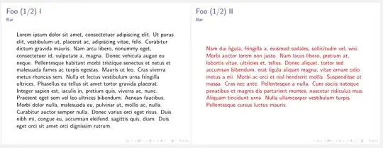

what it do, but consider solution suggested in @samcarter_is_at_topanswers.xyz answer frame is not divided on slides:
But when I uncomment lines in above MWE, slides appear, but numbering not works anymore as expected...

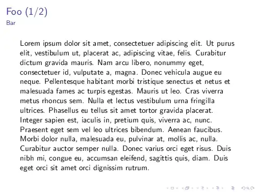

You could calculate the total number of slides within the frame from the start and end pages of the frame:
\documentclass{beamer}
\makeatletter \newcommand*{\slideinframe}{\number\beamer@slideinframe} \newcounter{bar} \newcommand{\foo}{% \setcounter{bar}{\insertframeendpage}% \addtocounter{bar}{-\insertframestartpage}% \addtocounter{bar}{1}% (\slideinframe/\thebar)% } \makeatother
\usepackage{lipsum}
\begin{document} \begin{frame} \frametitle{Foo \foo} \only<+>{ \framesubtitle{Bar} \lipsum[1] } \only<+>{ \framesubtitle{Baz} \color{red}\lipsum[2] } \end{frame} \end{document}
  • Thank you very much for fast response. It almost work as desired ... with you solution I have problem how to insert text in each slide in frame. If I insert for example \lipsum[1] after eacj subtitle ,, text are not in own slide, but it continues and is cut after first frame. Adding allowsframebreaks resulted in correct breaking frame into slides, but numbering is corrupted. SO so far only +1 for your effort. – Zarko Jan 28 '24 at 19:14
  • @Zarko Don't combine this with allowframebreaks, this option is not really compatible with overlays. Instead use \only<...>{...} etc. to split your text across the slides. – samcarter_is_at_topanswers.xyz Jan 28 '24 at 19:17
  • Hm, this not work as I expected. No separated slides are produced. What then I should do, that thew will do so? – Zarko Jan 28 '24 at 19:33
  • @Zarko A starting point would be to show your code. – samcarter_is_at_topanswers.xyz Jan 28 '24 at 19:35
  • Now is added MWE by which I tested your solution. – Zarko Jan 28 '24 at 19:59
  • @Zarko See my updated answer – samcarter_is_at_topanswers.xyz Jan 28 '24 at 20:06
  • Thank you very much! Now I see where I should insert my slide contents. Sorry, that I didn't figured out this myself ... – Zarko Jan 28 '24 at 20:18
