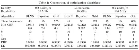

The OP's tabularx environment doesn't employ a single X-type column. Hence, achieving the stated target width (here: \textwidth) is doomed from the start.
A cursory inspection of the table further reveals that automatic line-wrapping is not needed anywhere. Hence, it would be more natural to employ a tabular* environment instead of a tabularx environment. Now, employing a tabular* environment properly requires the user to get rid of all vertical rules -- which is a good idea anyway. I'd also recommend fewer, but well-spaced, horizontal rules, with the help of the macros of the booktabs package.
I would further take care to provide some visually discernible structure to the header material. Merely providing a large number of horizontal rules does not qualify as furnishing a visually discernible structure.
\documentclass[twocolumn]{article} % or some other suitable document class
\usepackage{booktabs} % for \toprule, \midrule, \cmidrule, and \bottomrule macros
\begin{document}
\begin{table*} % span both columns of text \setlength\tabcolsep{0pt} % make LaTeX determine intercolumn spacing amount \caption{Comparison of optimization algorithms} \label{my-label}
\smallskip \begin{tabular}{\textwidth}{@{\extracolsep{\fill}} l {9}{c} } \toprule Density & \multicolumn{3}{c}{ 0.2 nodes/m } & \multicolumn{3}{c}{ 0.3 nodes/m } & \multicolumn{3}{c}{ 0.2 nodes/m } \
Bandwidth & \multicolumn{3}{c}{ 20 MHz } & \multicolumn{3}{c}{ 20 MHz } & \multicolumn{3}{c}{ 120 MHz } \ \cmidrule{2-4} \cmidrule{5-7} \cmidrule{8-10} Algorithm & DLNN & Bayesian & Grid & DLNN & Bayesian & Grid & DLNN & Bayesian & Grid \ \midrule Time, in seconds & 40 & 85 & 575 & 45 & 90 & 573 & 45 & 85 & 658 \
Min CBR & 0.0618 & 0.0175 & 0.0168 & 0.02635 & 0.0272 & 0.0263 & 0.0022 & 0.0022 & 0.0021 \
$\gamma$ & 6.8 & 2.6 & 6.8 & 9 & 3.367 & 8.9 & 1.14 & 2.202 & 0.9 \
$k$ &10 & 8 & 8 & 10 & 8 & 10 & 10 & 10 & 10 \
$\lambda$ & 1 & 1 & 1 & 1 & 1 & 1 & 1 & 1 & 1 \
Nrp & 1 & 1 & 1 & 1 & 1 & 1 & 1 & 1 & 1 \
PRP & 0.9991 & 0.9993 & 0.9990 & 0.9990 & 0.9990 & 0.9990 & 0.9997 & 0.9997 & 0.9992 \
ED & 0.00040 & 0.00043 & 0.00040 & 0.00040 & 0.00046 & 0.00040 & 5.5E-05 & 5.6E-05 & 6.0E-05 \ \bottomrule \end{tabular} \end{table}
\end{document}
