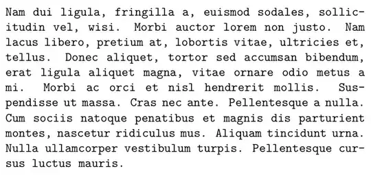

If you need to reproduce a document prepared with a typewriter, the setup
\documentclass{article}
\usepackage{fontspec}
\usepackage{ragged2e}
\setmainfont[Ligatures=TeX]{Latin Modern Mono}% choose another one if you prefer
\begin{document}
% Uncomment the following line for standard spaces after periods
%\frenchspacing
% Uncomment the following line for ragged right setup
%\setlength{\RaggedRightRightskip}{0pt plus 4em}\RaggedRight
with XeLaTeX seems the best option.
Here's the result when applying both \frenchspacing and \RaggedRight:
egreg
  • 1,121,712
    Wouldn't it be more authentic to a typewriter not to use Ligatures=TeX? Or are there reasons to use them anyway? – cgnieder Sep 09 '12 at 13:39
  • @cgnieder Possibly. That's only in order to make input of dashes easier, but in a fixed width font one should use only a hyphen. Maybe for ¡ and ¿, depending on the keyboard facilities. – egreg Sep 09 '12 at 13:41
  • This has at least the problem of the extra spaces after the period (see especially the alignment of the is pretium on the third line and aliquet on the fourth. – Daniel H Sep 09 '12 at 18:07
  • @DanielH It depends on the typewriting school; I'll add the result from applying \RaggedRight and \frenchspacing – egreg Sep 09 '12 at 19:32
