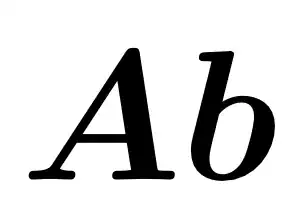

$\mat{a}\vec{B}$
\end{document}
With this code you'd get
Package tsjolder/vec-mat Warning: WARNING: lowercase used when uppercase is
(tsjolder/vec-mat)                expected on line 41
Package tsjolder/vec-mat Warning: WARNING: uppercase used when lowercase is (tsjolder/vec-mat) expected on line 41
in the log file and on the terminal, but the output will be correct anyway.
