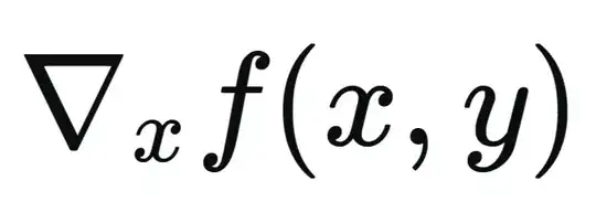

With the command \nabla_x f(x, y), I have enter image description here
I think this is not aesthetic. Is there a way to get the subscript closer to the tip of nabla symbol? Something looks like enter image description here

Define a new command that nudges in the subscript (when present).
\documentclass{article}
\usepackage{amsmath}
\NewDocumentCommand{\Nabla}{e{^}}{% \nabla \IfValueT{#1}{{!#1}}% \IfValueT{#2}{^{#2}}% }
\begin{document}
[ \Nabla_{x} f(x,y) ]
[ \Nabla f\quad \Nabla^{2} f \quad \Nabla^{2}_{x} f ]
\end{document}

Simply using \! a negative space.
\usepackage{mathtools}
\begin{document}
[ \boldsymbol{\nabla}_{!x}^{2} f(x, y) ]
\end{document}
