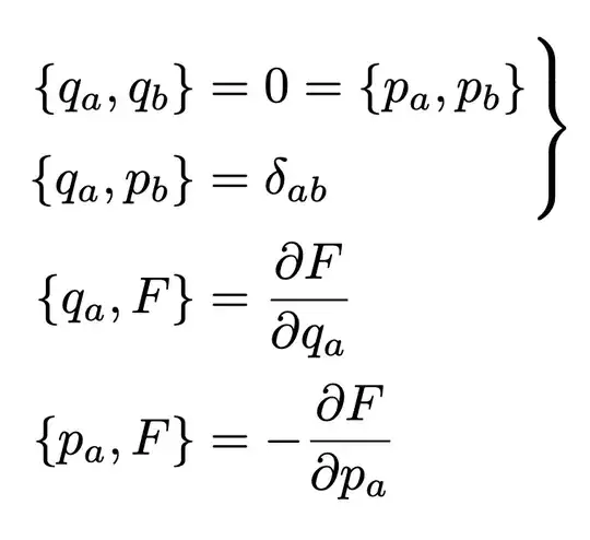

I want to add a curly bracket to the right of the two first lines : Structure

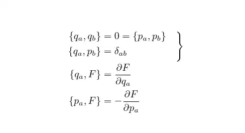

You can position a large } while hiding it from the alignment:
\documentclass[a4paper]{article}
\usepackage{mathtools,derivative}
\begin{document}
\begin{align} {q_a,q_b} &= 0 = {p_a,p_b} \quad\smash{\raisebox{-10pt}{$\mathrlap{\Biggr}}$}}\ {q_a,p_b} &= \delta_{ab} \[2pt] {q_a,F} &= \pdv{F}{q_a}\ {p_a,F} &= -\pdv{F}{p_a} \end{align}
\end{document}

You can use nicematrix:
\usepackage{derivative}
\usepackage{nicematrix}
\begin{document}
\begin{equation} \setlength{\arraycolsep}{0pt} \renewcommand{\arraystretch}{1.5} \begin{NiceArray}{r >{{}}c<{{}} >{\displaystyle}l} {q_a,q_b} &=& 0 = {p_a,p_b} \ {q_a,p_b} &=& \delta_{ab} \[1ex] {q_a,F} &=& \pdv{F}{q_a}\[2ex] {p_a,F} &=& -\pdv{F}{p_a} \CodeAfter\SubMatrix.{1-3}{2-3}} \end{NiceArray} \end{equation}
\end{document}
