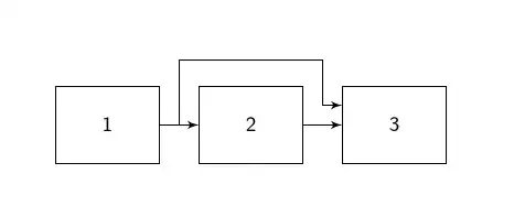

How to add this line?
enter image description here Current code:

My try: \draw[->,line width=0.25mm] ($(1)!0.5!(2)$) --++ (0,1cm) -| (3);

You can name a coordinate on the segment from (1) to (2) just like a node. The midpoint of the line is the default. Then you can draw the new arrow from there.
The point (3.160) is on the boundary of node (3) at an angle of 160 degrees (slightly above west which would be 180). You could alternatively use ([yshift=3mm]3.west) for the final point, which would be 3mm above center.

\draw[->,line width=0.25mm] (1) --coordinate(M1) (2);
\draw[->,line width=0.25mm] (2) --coordinate(M2) (3);
\draw[->,line width=0.25mm] (M1) |- ([yshift=9mm]M2) |- (3.160);

Based on my answer on your previous question, i.e. by use of the chains and ext.paths.ortho libraries. My MWE is focused only on your problem, so in comparison to your MWE it is quite shorter, however by the way it also show how can you block schemes can be drawn more efficiently:

\begin{document} \begin{tikzpicture}[ node distance = 4mm and 6mm, start chain = going right, arr/.style = {-{Straight Barb[scale=0.8]}, semithick}, box/.style = {% default is rectangle draw, minimum height = 10mm, minimum width=20mm, on chain, join=by arr} ] \foreach \i in {1,2,3} \node [box] (n\i) {\i}; % nodes are in chain % \path (n1) -- coordinate (aux) (n2); % defined coordinate between nodes n1 and n2 \draw[arr] (aux) |- ([yshift=5mm] n2.north) % first part of arrow
-|- [distance=-3mm] ([yshift=3mm] n3.west); % second part of arrow \end{tikzpicture} \end{document}

We can use |- to go first vertically and then horizontally from point A to point B. (Or -| for horizontal and then vertical movement.)
We can also use 2.east as a rough marker. If we can ([yshift=1cm]2.east) for the second point, we'll end up above the right most side of 2. So we could say
$(1)!.5!(2)$ |- (yshift=1cm]2.east
for the first part. Now we need to go across a bit more, then down and then across to a point a bit above 3.west. Let's take the halfway point between the west and north west anchors, ($(3.west)!.5!(3.north west)$).
We could manage the changes of direction with a manual adjustment and either -| or |-, but why go to the trouble if we don't have to?
The ext.paths.ortho library allows us to use an enhanced syntax for specifying paths. In our case -|- tells tikz to go horizontally, then vertically, then horizontally between two points.
\draw[->,line width=0.25mm] ($(1.east)!0.5!(2.west)$) |- ([yshift=1cm]2.east) -|- ($(3.west)!.5!(3.north west)$);
diverted arrow up across across down across

Like this:

\draw[-latex,line width=3pt] (1) -- (2); \draw[-latex,line width=3pt] (2) -- (3); \draw[-latex,line width=3pt] (2.5,0)--(2.5,2)--(7.5,2)--(7.5,.5)--(8.5,.5);
