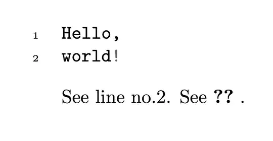

Here is my code:
\documentclass{article}
\usepackage{minted}
\usepackage{cleveref}
\begin{document}
\begin{minted}[linenos,escapeinside=||]{cpp}
Hello,
world! |\label{foo}|
\end{minted}
See line no.\ref{foo}.
See \cref{foo}.
\end{document}
It renders:
How to fix?
