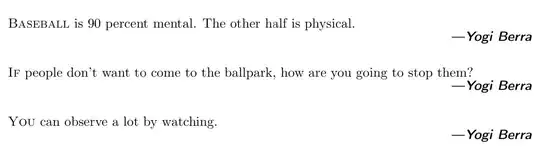

Consider the code
\documentclass[12pt]{book}
\usepackage[T1]{fontenc}
%\usepackage[sfdefault]{cabin}
\newcommand{\longemdash}{{\fontfamily{cmss}\selectfont---}} \newcommand{\emdash}{\nobreak---\nobreak\hskip0pt}
\newcommand{\fancyquote}[2]{% \par\noindent{#1}\\hspace{\fill}\longemdash\fontfamily{cmss}\selectfont\textit{\textbf{#2}}% }
\begin{document} \thispagestyle{empty}
\fancyquote{{\scshape{Baseball}} is 90 percent mental. The other half is physical.}{Yogi Berra}
\vspace*{20pt}
\fancyquote{If people don't want to come to the ballpark, how are you going to stop them?}{Yogi Berra}
\vspace*{20pt}
\fancyquote{You can observe a lot by watching.}{Yogi Berra} \end{document}
which produces
QUESTION: How may I automatically display the first word of every quote in small caps without having to resort to something {\scshape{Baseball} every time?
Thank you.
Mico

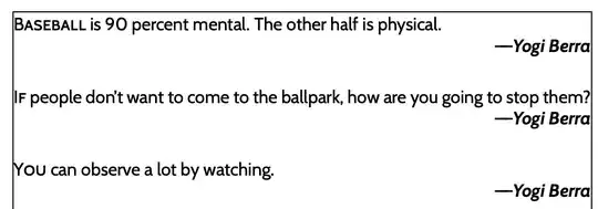

Isolate the first word with a delimited argument.
\usepackage{showframe}
\newcommand{\longemdash}{\makebox[1em][s]{---\hss---}}
\makeatletter \newcommand{\fancyquote}[2]{% \fancyquote@#1@nil{#2}% } \def\fancyquote@#1 #2@nil#3{% \par\noindent\textsc{#1} #2\\hspace{\fill}\longemdash{\itshape\bfseries#3}% } \makeatother
\fancyquote{Baseball is 90 percent mental. The other half is physical.}{Yogi Berra}
\vspace*{20pt}
\vspace*{20pt}
\end{document}
egreg
  • 1,121,712
Your first \fancyquote doesn't reset the font afterward, so your subsequent text is still in the cmss family. I think this was unintentional, so I changed that in my solution.
My solution works in plain TeX, it simply delimits the parameter in a TeX macro with a space.
