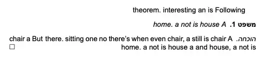

This post is a direct extension of this one. How can I define a proof environment with a different typeset name than "Proof" in a non-English document in addition to the original proof environment, rather than in lieu of it?
The language I am interested in is Hebrew, and the LaTeX language support I use is provided by the polyglossia package in tandem with the xelatex engine, but I'm also interested in the combination babel + lualatex.
Following is a LaTeX document, saved as ~/test.tex, as a starting point.
\documentclass{article}
\usepackage{amsthm}
\newtheorem{theorem}{משפט}
\usepackage{polyglossia} \setmainlanguage{hebrew} \setmainfont{Arial} \begin{document}
Following is an interesting theorem. \begin{theorem} A house is not a home. \end{theorem} \begin{proof} A chair is still a chair, even when there's no one sitting there. But a chair is not a house, and a house is not a home. \end{proof}
\end{document}
When the following instructions are executed in the Terminal:
> cd ~
> xelatex test
the file ~/test.pdf is created. When opened in a PDF viewer, the file displays as follows.
A basic framework for a mathematical paper in Hebrew.
Note that Hebrew is a right-to-left language.
The desired solution would enable me to add the following to ~\test.tex immediately below the \end{proof} line:
\begin{explanation}
\end{explanation}
with the resulting PDF file displaying like this:
Desired output
Note that the desired output can be accomplished on an ad-hoc basis by adding the option [הסבר] to the proof environment, thus: \begin{proof}[הסבר] ... \end{proof}. However, I'm looking for a solution that would enable me to declare a new environment with a different name than proof.

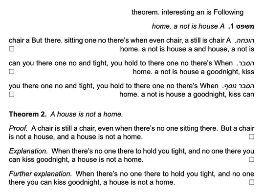

    @EvanAad I added a perhaps simpler approach. – egreg Nov 13 '22 at 11:31
You want to add to \captions<language>.
\usepackage{amsthm}
\setmainlanguage{hebrew} \setotherlanguage{english} \setmainfont{Arial}
\newtheorem{theorem}{\theoremname} \newenvironment{explanation} {\let\proofname\explanationname\begin{proof}}% {\end{proof}}
\newcommand{\theoremname}{Theorem}% default \newcommand{\explanationname}{Explanation}% default \appto{\captionshebrew}{% \renewcommand\theoremname{משפט}% \renewcommand\explanationname{הסבר}% } \appto{\captionsenglish}{% \renewcommand\theoremname{Theorem}% \renewcommand\explanationname{Explanation}% }
\begin{document}
\begin{theorem} A house is not a home. \end{theorem} \begin{proof} A chair is still a chair, even when there's no one sitting there. But a chair is not a house, and a house is not a home. \end{proof} \begin{explanation} When there's no one there to hold you tight, and no one there you can kiss goodnight, a house is not a home. \end{explanation}
\selectlanguage{english}
\end{document}
A slightly different approach, perhaps simpler.
\usepackage{amsthm}
\NewDocumentEnvironment{explanation}{o} {\IfNoValueTF{#1}{\proof[\explanationname]}{\proof[#1]}} {\endproof}
\begin{document}
\begin{theorem} A house is not a home. \end{theorem} \begin{proof} A chair is still a chair, even when there's no one sitting there. But a chair is not a house, and a house is not a home. \end{proof} \begin{explanation} When there's no one there to hold you tight, and no one there you can kiss goodnight, a house is not a home. \end{explanation} \begin{explanation}[הסבר נוסף] When there's no one there to hold you tight, and no one there you can kiss goodnight, a house is not a home. \end{explanation}
\begin{theorem} A house is not a home. \end{theorem} \begin{proof} A chair is still a chair, even when there's no one sitting there. But a chair is not a house, and a house is not a home. \end{proof} \begin{explanation} When there's no one there to hold you tight, and no one there you can kiss goodnight, a house is not a home. \end{explanation} \begin{explanation}[Further explanation] When there's no one there to hold you tight, and no one there you can kiss goodnight, a house is not a home. \end{explanation}
\end{document}
egreg
