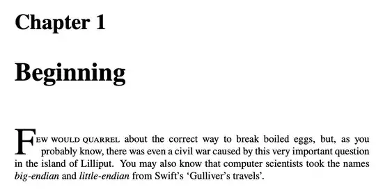

You can use the package lettrine to do the job.
\documentclass{book}
\usepackage{newtxtext} % you want true small caps
\usepackage{lettrine}
\begin{document}
\chapter{Beginning}
\lettrine{F}{ew would quarrel} about the correct way to break boiled eggs, but, as you probably know, there was even a civil war caused by this very important question in the island of Lilliput. You may also know that computer scientists took the names \emph{big-endian} and \emph{little-endian} from Swift's `Gulliver's travels'.
\end{document}
But you seem to want a slightly different output, with the lettrine (that means “drop cap” in French) sticking up. If you type
\lettrine[loversize=0.5]{F}{ew would quarrel}
then the output would be
But you don't need to add loversize=0.5 every time. Just add the appropriate setting in the document preamble.
