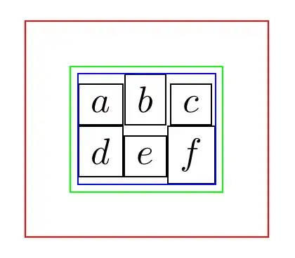

To my knowledge there is no inner sep parameter for the matrix node. So, when certain inner sep is fixed it decides the inner separation of nodes, but also the separation between nodes and matrix border. To avoid this behaviour, you should use M. Al Jumaily's solution: nodes={inner sep=...}.
If you don't liker it, a possible alternative could be to not draw the matrix border and draw it with a fit node. In this case, you keep original nodes inner sep (initially .3333em) and can draw the border to whatever separation you decide.
Following code shows this solution. The matrix border is not draw and three different borders are added with fit nodes.
I think it's not a good solution because you have to distinguish between real matrix node and fitting node and you have to know which inner nodes are larger to include them inside fit list.
\documentclass{article}
\usepackage{tikz} \usetikzlibrary{matrix, fit} % for "matrix of math nodes"
\begin{document}
\begin{equation} \begin{tikzpicture}[baseline=(current bounding box.center)] \matrix[matrix of math nodes, nodes={draw}] (A) { a & b & c \ d & e & f \ }; \node[fit={(A-1-1) (A-1-2) (A-2-3)}, inner sep=0pt, draw=green, inner sep=2pt] (B) {}; \node[fit={(A-1-1) (A-1-2) (A-2-3)}, inner sep=0pt, draw=blue, inner sep=0pt] (C) {}; \node[fit={(A-1-1) (A-1-2) (A-2-3)}, inner sep=0pt, draw=red, inner sep=5mm] (D) {}; \end{tikzpicture} \end{equation}
\end{document}
