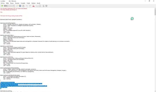

I want to cite as defined in this link. However, if I paste in my bib file what the kink contains,
@article{planning2010concept,
  title={Concept of Operations for the Next Generation Air Transportation System, Ver. 3.2},
  author={Planning, Joint and others},
  journal={http://ntrs. nasa. gov/archive/nasa/casi. ntrs. nasa. gov/20110008502\_2011007120. pdf},
  year={2010}
Then, the year does not appear after journal, as can be seen in the attached figure.
output of the bibliography
I am also attaching a .bib screenshot of how my bibliography looks
my bibliography

    Note: for internet sources, you really shouldn't abuse the @article like that. Use @misc. See https://tex.stackexchange.com/questions/3587/how-can-i-use-bibtex-to-cite-a-web-page The use of the journal and author fields are both semantically incorrect. – Willie Wong Jul 06 '22 at 19:04
  • That said, for trouble shooting you need to show us what \bibliographystyle you are using at least. If I just copy the .bib entry from your question into an empty file, and cite it in an article with \bibliogaphystyle{unsrt}, the year shows up just fine. So the problem (whatever it is) resides with information that you have withheld from us. – Willie Wong Jul 06 '22 at 19:12
  • @WillieWong Thanks, now the date appears but the link does not, can you help me with that too? About journal and author, I can change the fields. And I have no idea about the bibliograpy style, I must be using the default – slow_learner Jul 06 '22 at 19:22
    (a) if you tried something and it didn't work, and you want to ask a follow up, please be precise about what you tried. (Show the code.) (b) I would suggest reading up a little bit on some bibtex guides (e.g. https://www.economics.utoronto.ca/osborne/latex/BIBTEX.HTM) so that when we try to troubleshoot, the questions we ask you make sense (c) Please update your question with the current status, so other users of this site can more quickly find what the current deal is without having to look through the comments. Thanks! – Willie Wong Jul 06 '22 at 20:15
  • Neither the author nor the url fields look correct. The author field should almost certainly be author={{Joint Planning and Development Office}}-- a "corporate" author. Why are there lots of spaces in the URL string? – Mico Jul 06 '22 at 20:46
