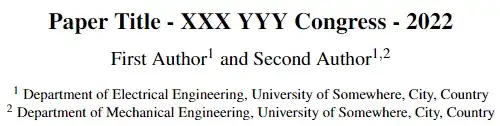

2 Doubt (solved): I've tried (without success) to add two affiliations to the same author. To solve it I've added the following code to the .cls file, according to this post.
\renewcommand{\author}[3][]{
      \stepcounter{ifmbe@authors}
      \expandafter\def\csname ifmbe@author\alph{ifmbe@authors}\endcsname
      {#2$^{\expandafter\the\csname ifmbe@affiliationcounter#3\endcsname
        \if\relax\detokenize{#1}\relax\else,#1\fi}$}
So, I've done the following in my main.tex providing the figure below.
\documentclass[nouppercase]{ifmbe}
\title{Paper Title - XXX YYY Congress - 2022}
\affiliation{Department of Electrical Engineering, University of Somewhere, City, Country}{FIRSTAFF} \affiliation{Department of Mechanical Engineering, University of Somewhere, City, Country}{SECONDAFF}
\author{First Author}{FIRSTAFF} % changed from \author{Second Author}{SECONDAFF} to: \author[2]{Second Author}{FIRSTAFF}

  • @PeterWilson thanks. I've added some code example above, but the main.tex in https://www.overleaf.com/read/qfycqqrwbwtg by itself is an MWE. I'd like the second author to be associated to both affiliations, preferably using their way of adding affiliations. – Mateus Schneider Castilhos Jun 23 '22 at 00:36
  • @PeterWilson I've solved the affiliations problem as above. But the section letters (second to last) keep around 10pt, and the required is 8pt. – Mateus Schneider Castilhos Jun 23 '22 at 21:15
