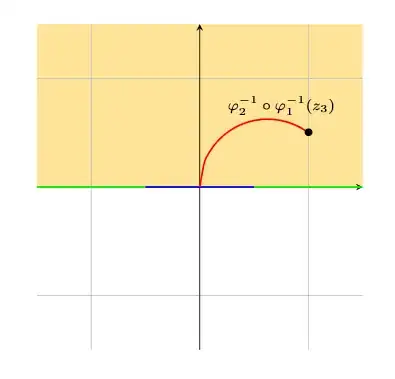

In the following code
\documentclass{article} \usepackage{tikz} \usepackage{pgfplots} \pgfplotsset{compat=1.17} \definecolor{gold}{RGB}{255, 184, 0}
\begin{document}
\begin{tikzpicture} \begin{axis}[ axis lines=center, grid=major, xmin=-3, xmax=3, ymin=-3, ymax=3, width=7cm, height=7cm, xticklabels={,,}, yticklabels={,,}, xtick style={draw=none}, ytick style={draw=none}, extra x ticks={-1,1}, extra x tick labels={,}, extra x tick style={color=black,grid=none}, set layers = standard]
\pgfonlayer{axis background}
\fill[gold!40] (-3,0) -- (3,0) -- (3,3) -- (-3,3);
\endpgfonlayer
\draw[green, thick] (-3,0) -- (-1,0);
\draw[green, thick] (1,0) -- (3,0);
\draw[blue, thick] (-1,0) -- (1,0);
\addplot[smooth, red, thick, domain={0:2}]{sqrt(2.5*x-x^2)};
\node (z3) at (2,1) {\small \textbullet};
\node at (1.5,1.5) {\scriptsize $\varphi_2^{-1}\circ\varphi_1^{-1}(z_3)$};   \end{axis}    \end{tikzpicture}
\end{document}
I want there to be two tick marks between the blue and green portions on the x-axis. If I comment out the line xtick style={draw=none}, then I get all the x tick marks showing up, which I don't want:
For reference, I've looked at Hide tick numbers in a TikZ/PGF axis environment. (taught me to use draw=none) and Remove a tick (pgfplots) (if I want to put draw=none in the extra ticks I can, but here I want to put draw=none on the regular ticks and only see the extra ticks).

You need to set major x tick style={draw=black} inside the extra x tick styleoption, then it works. See also this answer.
\begin{document}
\begin{tikzpicture} \begin{axis}[ axis lines=center, grid=major, xmin=-3, xmax=3, ymin=-3, ymax=3, width=7cm, height=7cm, xticklabels={,,}, yticklabels={,,}, x tick style={draw=none}, y tick style={draw=none}, extra x ticks={-1,1}, extra x tick labels={-1,1}, extra x tick style={major x tick style={draw,black},grid=none}, set layers = standard]
