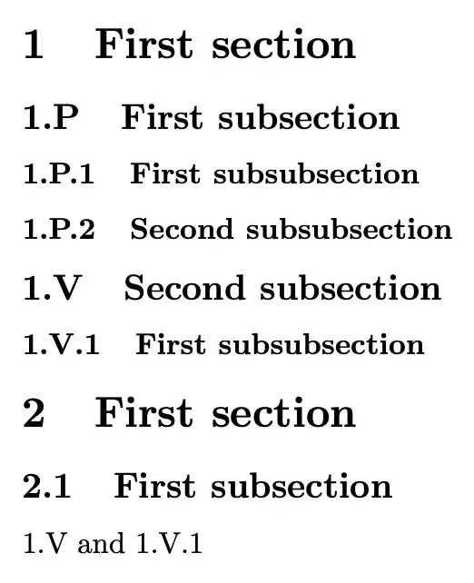

You might extend the \subsection command to take an optional argument in parentheses; in this case, the argument will be used instead of the number.
\documentclass{article}
\NewCommandCopy{\originalsubsection}{\subsection} \RenewDocumentCommand{\subsection}{sd()O{#4}m}{% \IfBooleanTF{#1} {\originalsubsection*{#4}}% {% \IfNoValueTF{#2} {% no letter \renewcommand{\thesubsection}{\thesection.\arabic{subsection}}% } {% letter \addtocounter{subsection}{-1}% \renewcommand{\thesubsection}{\thesection.#2}% } \originalsubsection[#3]{#4}% }% }

\section{First section}
\subsection(P){First subsection}
\subsubsection{First subsubsection}
\subsubsection{Second subsubsection}
\subsection(V){Second subsection}\label{v}
\subsubsection{First subsubsection}\label{1-v}
\subsection{First subsection}
\ref{v} and \ref{1-v}
\end{document}
In order for hyperref to work, add also
\renewcommand{\theHsubsection}{\thesubsection}
at the end of the given code.
